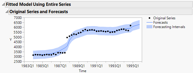

Figure 19.1 Original Series and Forecasts
