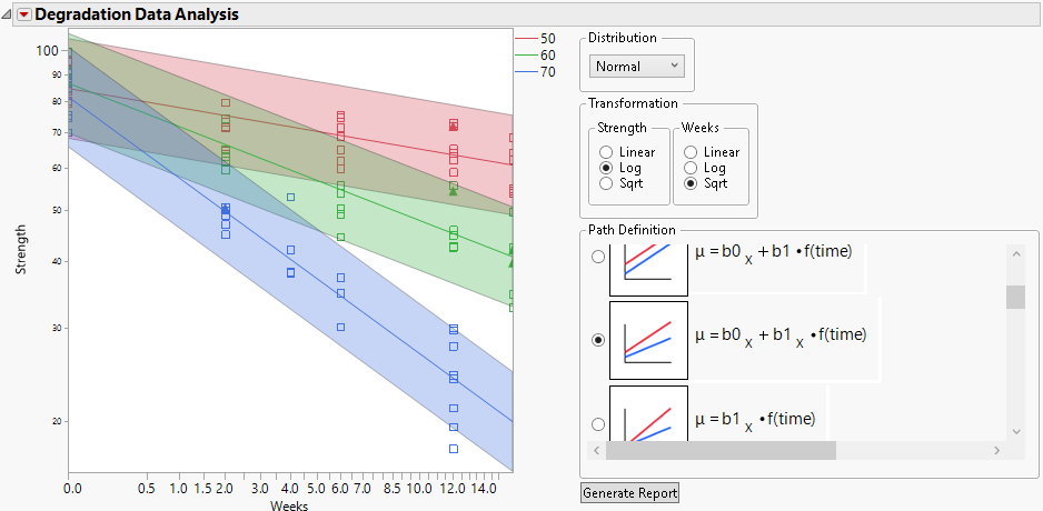

Figure 9.1 Destructive Degradation Example of Model for Adhesive Bond.jmp
