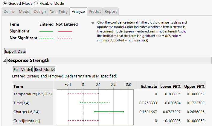

Figure 7.1 Easy DOE Response Strength PlotĀ
