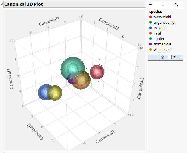

Perform Discriminant Analysis
10. Select Analyze > Multivariate Methods > Discriminant.
11. Select skull length, teeth row, palatine foramen, and jaw length and click Y, Covariates.
12. Select species and click X, Categories.
13. Click OK.
14. Click the Discriminant Analysis red triangle and click Canonical 3D Plot.
Figure 5.14 Canonical 3D Plot with Legend Window
You can click categories in the Legend to highlight those points in the Canonical 3D plot. You can also click and drag inside the 3D plot to rotate it.
