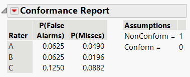

8. Open the Effectiveness Report and scroll down to the Conformance Report.
You can see that 0 = non-conform (fail) and a 1 = conform (pass). However in this data, it is exactly the opposite: 0 is a pass and 1 is a fail. Reverse this setting.
9. Click the Conformance Report red triangle and select Change Conforming Category.
Figure 7.4 Conformance Report
Conformance Report
