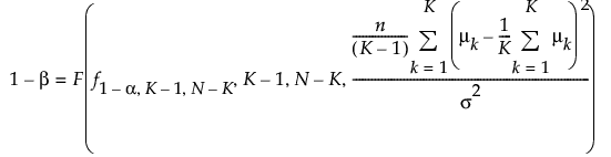

Statistical Details for the Power for ANOVA Explorer
The power calculations for testing differences among means from multiple groups assumes equal standard deviations for each group. Power calculations are based on the standard F test. The power (1-β) is computed based on the test specification.
For group means:
Equation shown here
For between-groups:
Equation shown here
For maximum difference, worst case:
Equation shown here
For maximum difference, all but one:
Equation shown here
where
F(q, df1, df2, λ) is a non-central F-distribution with noncentrality parameter λ.
K is the number of groups
n is the number of samples within each group (assumed equal for all groups)
N = nK
μk is the assumed mean for group k
σ2BG is the sum of the squared differences between the group means and the grand mean scaled by 1/(K-1)
δWC is the difference between the largest and smallest group means
δABO is the difference between one mean and the average of all other means
σ2 is the within-group variance (assumed equal for all groups)
