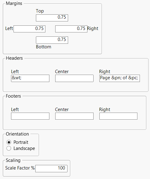

The Print pages enables you to configure default print settings such as, margins, header, and footers.
Figure 14.26 Print Preferences
Print Preferences
Table 14.25 Preferences on the Print Page
Preference
Description
Top (margin)
Sets the print page’s top margin. The default setting is 0.75 inches.
Left (margin)
Sets the print page’s left margin. The default setting is 0.75 inches.
Right (margin)
Sets the print page’s right margin. The default setting is 0.75 inches.
Bottom (margin)
Sets the print page’s bottom margin. The default setting is 0.75 inches.
Left (header)
Sets the page’s left-side header information. The default setting is &wt; (that is, the title).
Center (header)
Sets the page’s center header information. The default setting is blank.
Right (header)
Sets the page’s right-side header information. The default setting is Page &pn; of &pc; (that is, Page # of count).
Left (footer)
Sets the page’s left-side footer information. The default setting is blank.
Center (footer)
Sets the page’s center footer information. The default setting is blank.
Right (footer)
Sets the page’s right-side footer information. The default setting is blank.
Orientation
Sets the page’s print orientation as either Portrait or Landscape. The default setting is Portrait.
Scale Factor
Sets the page’s print scaling factor (in percent). The default setting is 100%.
Note: The code for printing the current date in the header or footer is &d.
