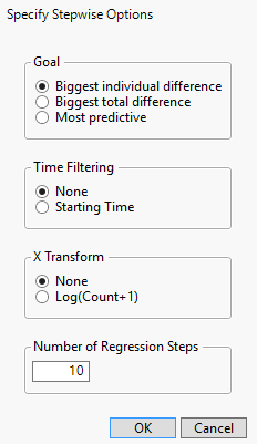

Stepwise Regression
Shows a Stepwise Regression window that enables you to specify options for a stepwise regression analysis. You can use stepwise regression to find problems in the process, where a problem is something that causes your yield to decrease. At each step in the regression, a term enters according to which term has the largest negative yield. This helps you identify process steps that most impact the yield. Stepwise Regression provides a table that shows the order in which terms entered the model at each step of the regression.
Note: If the Goal is to Minimize Y option is selected in the launch window, Stepwise Regression adjusts to detect terms that cause the yield to increase.
Goal
Specifies the criterion used in the stepwise regression model. The Biggest individual difference option identifies the terms that individually cause the yield to change the most. The Biggest total difference option identifies the terms that cause the biggest total difference, which is the difference multiplied by the number of units affected. The Most predictive option produces a traditional stepwise regression model.
Time Filtering
Enables you to use the starting time of a component in the stepwise regression model. If you choose the None option, the times are averaged over the entire time period. If you choose the Starting Time option, the component is allowed to fail at a particular starting time. The starting time is the time that maximizes the negative yield affect. If you choose the Starting Time option, the Stepwise Regression report table contains a Start Time column.
X Transform
Enables you to use the regular count data or the Log(Count + 1) data for the X, Process variables in the stepwise regression. The Log(Count + 1) option transforms the variables in the regression such that high frequency counts have less of a linear influence in the regression. If you choose the None option, high frequency counts have a linear influence in the regression.
Number of Regression Steps
The number of steps in the Stepwise Regression analysis. The default is ten.
Figure 27.4 Stepwise Regression Window
