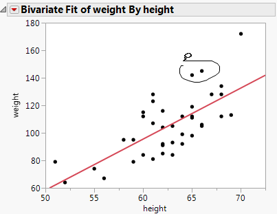

3. Drag the lasso around any set of points.
Figure 9.21 Using the Lasso Tool
4. Release the mouse. JMP automatically closes the lasso and highlights the points within the enclosed area.
