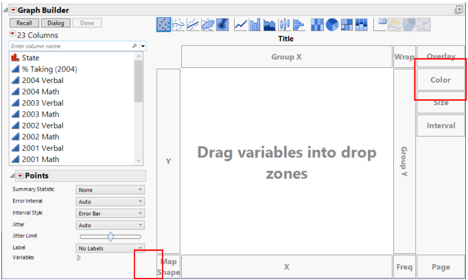

Open a data table that contains geographic data. Launch Graph Builder by selecting Graph > Graph Builder. The primary element in the Graph Builder window is the graph area. The graph area contains drop zones (Map Shape, Color and Size), and you can drag and drop variables into the zones. From here you can map shapes for data tables that include place names.
Figure 12.3 The Graph Builder Window
