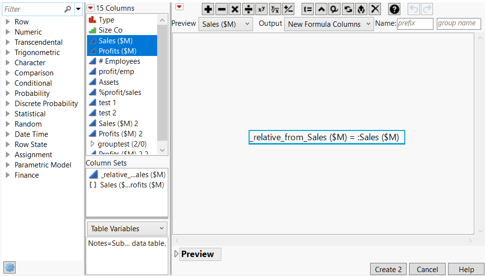

The following example shows how to open the Formula Editor for one or more columns.
1. Select the column(s) you wish to transform and right-click in their column header.
2. Select New Formula Column > Formula
The Formula Editor appears for the selected columns.
Figure 4.43 Creating Formula Columns with the Formula Editor
Use the Column Sets panel to work with sets of columns. This panel is available by opening the Formula Editor by selecting multiple columns. Use these sets as formula elements with functions that operate column-wise, like Sum and Median.
Two initial sets will be available when working with multiple columns.
The first set option, the floating column reference, is represented by the data type of the columns and prefixed by “_relative_from_”. This option treats each element of the set individually.
The second option, represented by the list icon , is a list of the entire group. This option treats all elements of the set as one list.
You can create new column sets relative to the initial set. Both the created and initial sets can then be used as formula elements.
1. With a data table open, select two or more columns you wish to transform and right-click in their column header.
The Formula Editor appears.
3. In the Columns panel, right-click a column, and select Create Floating Column Reference.
A column set containing the selected column and subsequent columns appears as a set in the Column Sets panel.
Sets created using Create Floating Column Reference contain the same number of columns as the initial set selected in step 1.
