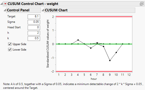

In this example, you want to be able to detect a 2σ shift in a process. A machine fills 8-ounce cans of two-cycle engine oil additive. The filling process is believed to be in statistical control. The process is set so that the average weight of a filled can (μ0) is 8.10 ounces. Previous analysis shows that the standard deviation of fill weights (σ0) is 0.05 ounces.
Subgroup samples of four cans are selected and weighed every hour for twelve hours. Each observation in the data table contains one value of weight and its associated value of hour. The observations are sorted so that the values of hour are in increasing order.
1. Select Help > Sample Data Folder and open Quality Control/Oil1 Cusum.jmp.
2. Select Analyze > Quality and Process > Control Chart > CUSUM Control Chart.
3. Select weight and click Y.
4. Select hour and click X.
5. Click OK.
6. In the Target box, type 8.1.
This is the target mean for the process.
7. In the Sigma box, type 0.05.
This is the known standard deviation for the process.
8. In the h box, type 2.
This defines the decision limits to be 2 standard deviations in each direction.
Figure 10.7 CUSUM Control Chart with Subgroups
The CUSUM Chart does not show any points outside of the upper or lower decision limits. There is no evidence that a shift in the process has occurred.
