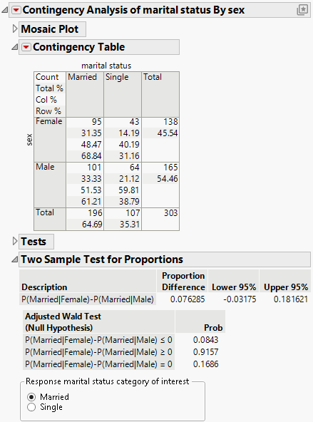

Use the Contingency platform to examine the probability of being married for males and females.
1. Select Help > Sample Data Folder and open Car Poll.jmp.
3. Select marital status and click Y, Response.
4. Select sex and click X, Factor.
5. Click OK.
6. Click the Contingency Analysis red triangle menu and select Two Sample Test for Proportions.
Figure 7.14 Example of the Two Sample Test for Proportions Report
In this example, you are comparing the probability of being married between females and males. See the Row% in the Contingency Table to obtain the following:
P(Married|Female) = 0.6884
P(Married|Male) = 0.6121
The difference between these two numbers, 0.0763, is the Proportion Difference shown in the report. The two-sided confidence interval is [-0.03175, 0.181621]. The p-value by the adjusted Wald method corresponding to the confidence interval is 0.1686, which is close to the p-value (0.1665) by Pearson’s chi-square test. The Pearson’s chi-square test is more common than the modified Wald’s test for testing the difference of two proportions.
