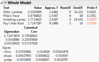

9. Click the Whole Model red triangle and select Test Details.
10. Click the Whole Model red triangle and select Save Canonical Scores.
Figure 10.12 Canonical CorrelationsĀ
The output canonical variables use the eigenvectors shown as the linear combination of the Y variables. For example, Canon[1] is calculated as follows:
0.02503681*chins + 0.00637953*situps + -0.0052909*jumps
This canonical analysis does not produce a standardized variable with mean 0 and standard deviation 1, but it is easy to define a new standardized variable with the calculator that has these features.
