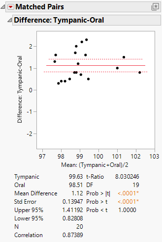

Figure 20.2 The Matched Pairs Report Window
The results show that, on average, the tympanic thermometer measures 1.12 degrees higher than the oral thermometer. The small p-value (Prob > |t|) indicates that this difference is statistically significant, and not due to chance.
Note that this matched pairs analysis does not indicate which thermometer is correct (if either), but indicates only that there is a difference between the thermometers.
