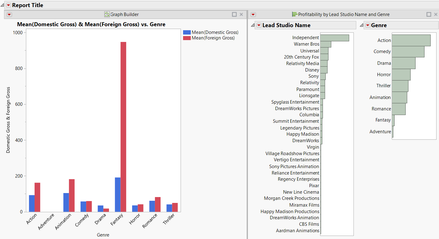

Suppose that you created two JMP reports and want to run the reports again the next day against an updated set of data. This example shows how to create a dashboard from the reports in Dashboard Builder.

5. In the Reports list, double-click the report thumbnails to put them on the dashboard.
6. Click the Dashboard Builder red triangle and select Preview Mode.
A preview of the dashboard appears. Notice that the graphs are linked to each other and the data table. They also have the same red triangle options as the Distribution and Graph Builder platforms.
7. Click Close Preview.
Figure 7.11 Dashboard with Two Reports
