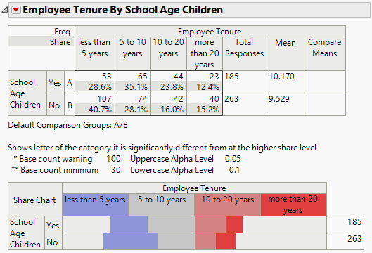

8. Select Analyze > Consumer Research > Categorical.
9. Select Employee Tenure and click Responses on the Simple tab.
10. Select School Age Children and click X, Grouping Category.
11. Click OK.
12. Click the Categorical red triangle and select Mean Score.
13. Click the Categorical red triangle and select Mean Score Comparisons.
Figure 3.41 Categorical Report with Mean Scores
The mean employee tenure for those with school age children is 10.17 and 9.53 for those without school age children. Because the means are not statistically different, the Compare Means column in the Crosstab table is empty. If there were a difference, a letter would indicate the difference. If you had not used value scores, then the mean for those with school age children would be 2.20 and 2.057 for those without school age children.
