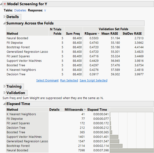

Image shown hereExample of Model Screening
You want to assess various models for their ability to predict diabetes disease progression. The data set includes baseline medical data for 442 patients who have diabetes and a continuous measure of diabetes disease progression obtained one year after each patient’s initial visit. Higher values correspond to more disease progression.
1. Select Help > Sample Data Folder and open Diabetes.jmp.
2. Select Analyze > Predictive Modeling > Model Screening.
3. Select Y and click Y, Response.
4. Select Age through Glucose and click X, Factor.
5. In the Folded Crossvalidation section, select the box next to K Fold Crossvalidation.
6. (Optional) In the Operational Options section, type 42920 next to Set Random Seed.
Use the random seed in order to match the example output.
7. Click OK.
8. Click the red triangle next to Model Screening for Y and select Optional Reports > Elapsed Time.
Figure 10.2 Model Report for Continuous Response
The best performing model based on the Validation RSquare averaged across the folds, is Neural Boosted. The average Validation RSquare for Neural Boosted is 0.5503. The Elapsed Time report shows that the Neural Boosted models also took the longest to fit. In this case, the elapsed time was only 5 seconds, but this information could be important for larger data sets or more complex models.
