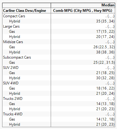

Example of Packing Columns
In this example, you want to compare median gas mileages for hybrid and non-hybrid engines across various manufacturers. Use the Pack Columns option to concisely show city, highway, and combined gas mileages.

Figure 9.27 Tabulate Report with Packed ColumnsĀ
The median gas mileages for hybrid vehicles is higher in each vehicle class. For example, the combined gas mileage for hybrid large cars is 20, and the combined gas mileage for gas large cars is 17.
