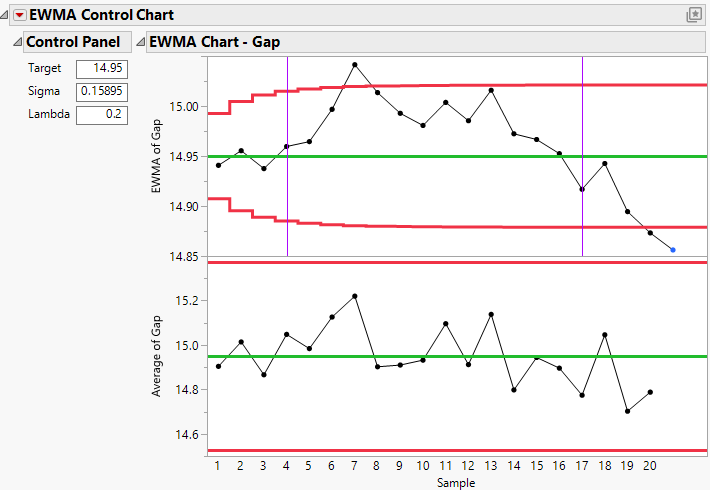

Figure 11.2 EWMA Control Chart
EWMA Control Chart
Purple vertical lines in the EWMA chart denote shifts. Shift starts are detected at samples 4 and 17.
