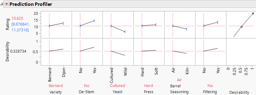

Figure A.29 Profiler with Original Value OrderĀ

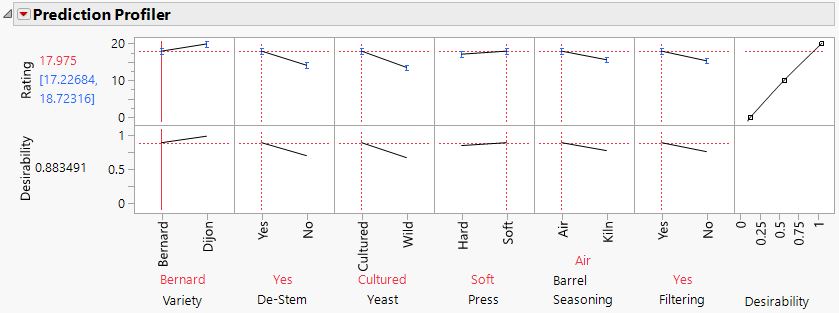

Notice that the values for De-Stem and Filtering appear in the order No followed by Yes. You want to reverse these, so that the Yes level appears first.
Tip: To arrange the profiler click the Prediction Profiler red triangle and select Appearance > Arrange in rows. For this example enter 7 and click OK.

Figure A.30 Profiler with New Value OrdersĀ
The levels for De-Stem and Filtering now appear in the order Yes followed by No.
