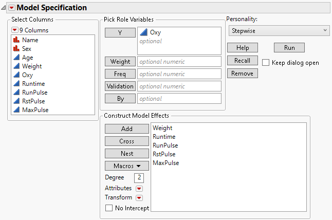

1. Select Help > Sample Data Folder and open Fitness.jmp.
3. Select Oxy and click Y.
4. Select Weight, Runtime, RunPulse, RstPulse, MaxPulse, and click Add.
5. For Personality, select Stepwise.
Figure 5.1 Completed Fit Model Launch Window
Image shown hereValidation is available only in JMP Pro.
6. Click Run.

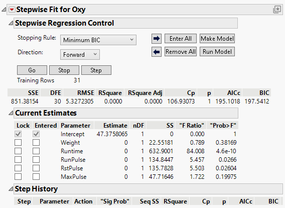

Figure 5.2 Stepwise Report Window
To find a good oxygen uptake prediction equation, you need to compare many different regression models. Use the options in the Stepwise report window to search through models with combinations of effects and choose the model that you want.
