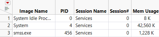

You can also print the task list directly without using cmd.exe and then import the task list into a data table.
blob = Run Program(
	Executable( "tasklist.exe" ),
	Read Function( "blob" )
Open(
	blob,
	Columns(
		Column( "Image Name", Character, "Nominal" ),
		Column(
			"PID",
			Numeric,
			"Continuous",
			Format( "Best", 10 )
		Column( "Session Name", Character, "Nominal" ),
		Column(
			"Session#",
			Numeric,
			"Continuous",
		Column( "Mem Usage", Character, "Nominal" ),
		Omitted Column( . )
	Import Settings(
		Fixed Column Widths( 26, 9, 17, 12, 12, 63 ),
		Labels( 1 ),
		Column Names Start( 2 ),
		Data Starts( 4 )
Figure 8.4 Imported Data from Run Program()
