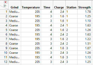

At this point in the DOE project, you are ready to perform the experiment. At each Station, four runs are conducted in the order shown in the design table. Equipment and material are reset between runs. For example, if two consecutive runs require water at 195 degrees, separate 12-ounce batches of water are heated to 195 degrees after the heating container cools. The Strength measurements are recorded.
Your design and the experimental results for Strength are given in the Coffee Data.jmp sample data table located in the Design Experiment folder.
Figure 3.11 Coffee Design with Strength ResultsĀ
