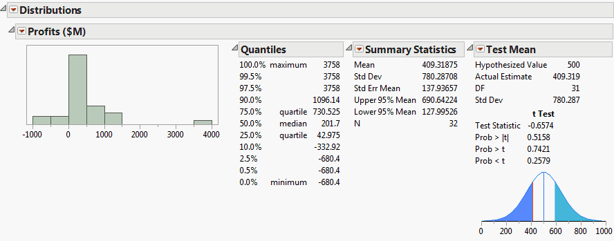

2. Select Analyze > Distribution to open the Distribution launch window.
3. Select Profits ($M) in the Select Columns box and click the Y, Columns button.
4. Click OK.
The Distribution report window appears.
5. Click the Distributions red triangle and select Stack to make your report horizontal.
6. Click the red triangle next to Profits ($M) and deselect Outlier Box Plot to turn the option off.
7. Click the red triangle next to Profits ($M) and select Test Mean.
The Test Mean window appears.
8. Type 500 in the Specify Hypothesized Mean box.
9. Click OK.
The test for the mean is added to the report window.
Now you have your customized report.
Figure 3.1 Customized Distribution Report

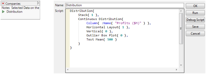

10. Click the Distributions red triangle and select Save Script > To Data Table.
Your data table now has a script named Distribution saved to it. Right-click the Distribution script and select Edit to see the script.
Figure 3.2 Distribution Script Saved to the Data Table
11. To run the script and reproduce your final report exactly, click the green triangle next to the script.
