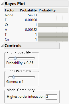

Figure 4.61 Bayes Plot for Factor Activity
The Model Complexity indicates that the highest order interaction to consider is two. Therefore, all possible models that include up to second-order interactions are constructed. Based on the value assigned to Prior Probability, a posterior probability is computed for each of the possible models. The probability for a factor is the sum of the probabilities for each of the models where it was involved.
This approach identifies Ct, T, and Cn as active factors, and A and F as inactive.
