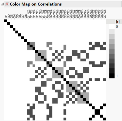

10. Click the gray disclosure icon to open the Design Evaluation section. Then click the gray disclosure icon to open the Color Map on Correlations section. Use the color map to help understand the structure of your design or to compare to other design options.
Figure 10.30 Color Map on Correlations for 16 Run Mixed-Level Screening Design
Use the color map to see that main effects are uncorrelated with two-factor interactions.
