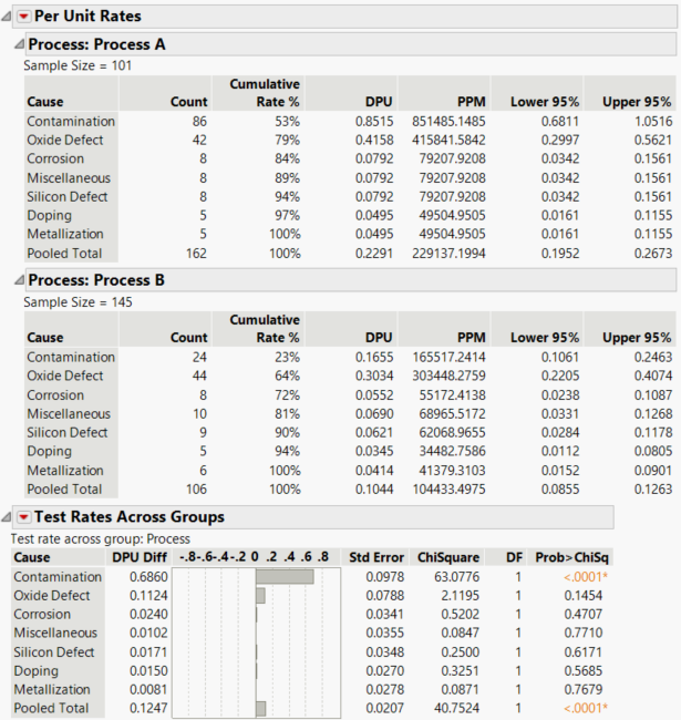

9. Click the Pareto Plot red triangle and select Per Unit Rates.
10. Click the Pareto Plot red triangle and select Test Rates Across Groups.
Figure 15.12 Per Unit Rates and Test Rates across Groups Results
Note that the sample size of 101 is used to calculate the DPU for the causes in group A. However, the sample size of 145 is used to calculate the DPU for the causes in group B.
If there are two group variables, Per Unit Rates lists DPU or rates for every combination of the grouping variables for each cause. However, Test Rate Across Groups tests only overall differences between groups.
