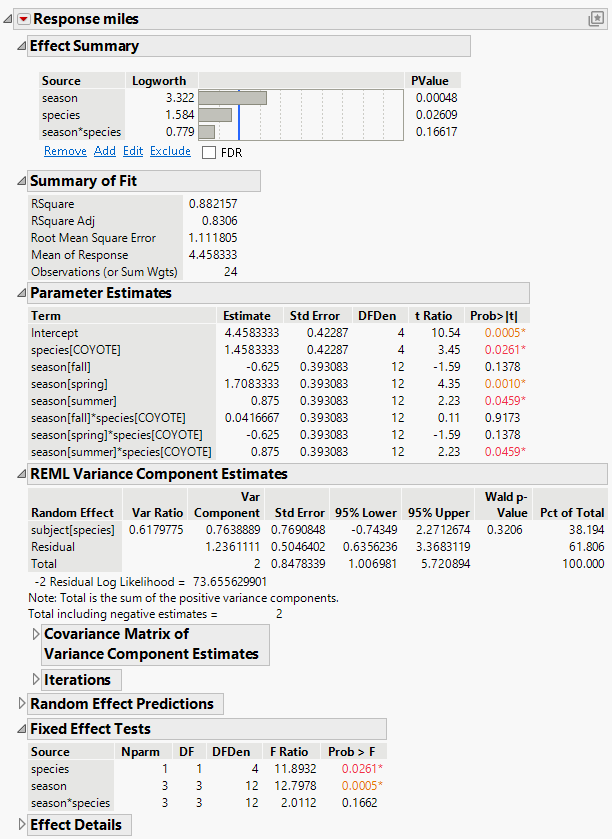

Figure 4.40 Partial Report of REML Analysis
The Effect Summary table indicates that both fixed effects, species and season, have a significant effect on the response variable miles. However, the interaction between season and species is not statistically significant. These results are also shown in the Fixed Effect Tests table.
The Parameter Estimates table indicates that the species[COYOTE], the season[spring], the season[summer], and the season[summer]*species[COYOTE] parameters have significant effects on miles, but the other variables and interactions are not statistically significant. The report also contains a REML Variance Component Estimates table for the random effects model that gives estimates of the subject within species and residual variances. Notice that the subject[species] random effect explains 38.194% of the total variance, and the residual component explains 61.806% of the total variance.
