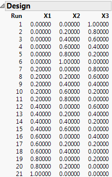

4. Click Simplex Lattice to generate the design.
Note: The default setting of 5 levels was used. There is a text box that enables you to adjust the number of levels
Figure 14.9 Three Factor Five-Level Simplex Lattice Design
5. Click Make Table.

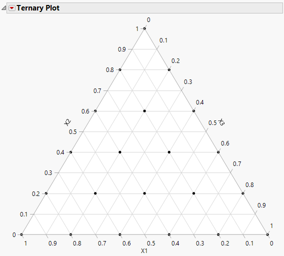

Visualize the Design
6. From the design table, select Graph >Ternary Plot.
7. Select X1, X2, and X3 and click X, Plotting, and then click OK.
Figure 14.10 Ternary Plot for Simplex Lattice Design
For more information about ternary plots, see Ternary Plot Overview.
As the number of levels increases, the number of design points increases, decreasing the space between design points. In contrast to the simplex centroid design, the simplex lattice design does not necessarily include the centroid.
