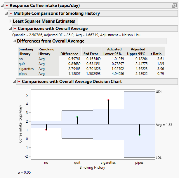

In this example, you are interested in whether the mean Coffee intake (cups/day) differs for subjects in any of the four Smoking History categories compared to the overall average coffee intake while controlling for alcohol use and heart history.

6. Click the red triangle next to Response Coffee intake (cups/day) and select Multiple Comparisons.
7. From the Choose an Effect list, select Smoking History.
8. In the Choose Initial Comparisons list, select Comparisons with Overall Average - ANOM.
9. Click OK.
Figure 4.45 Comparisons with Overall Average for RatingsĀ
The results in the Comparisons with Overall Average report indicate that the least squares means for non-smokers and cigarette smokers differ significantly from the overall average in terms of coffee intake.
