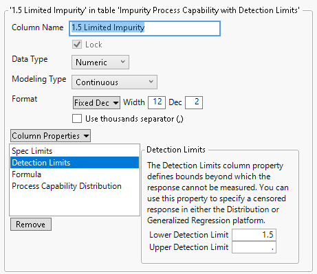

This data table contains four columns with varying levels of a lower limit of detection. For example, in the 1.5 Limited Impurity column, all values of Actual Impurity that are less than 1.5 have been changed to 1.5 and the column has a Detection Limits column property that specifies 1.5 as the Lower Detection Limit, the value below which the response cannot be measured.
2. (Optional.) View the Detection Limits column property for the 1.5 Limited Impurity column.
1. Click on the asterisk icon next to 1.5 Limited Impurity in the Columns panel of the data table window.
2. Select Detection Limits.
Figure 3.24 Column Information Window for 1.5 Limited Impurity Column
3. Click OK.

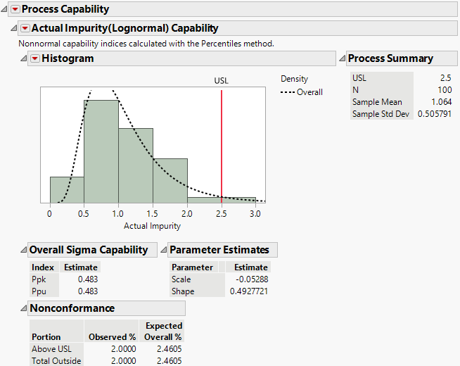

8. Click the Actual Impurity red triangle and select Continuous Fit > Fit Lognormal.
9. Click the Fitted Lognormal Distribution red triangle and select Process Capability.
The Process Capability Analysis window uses 2.5 as the upper specification limit. This value comes from the Spec Limits column property for the Actual Impurity column.
10. Click OK.
11. (Optional.) Click the Actual Impurity red triangle and select Histogram Options > Histogram.
Hiding the histogram report frees up space for the process capability analysis.
Figure 3.25 Process Capability Report for Actual Impurity

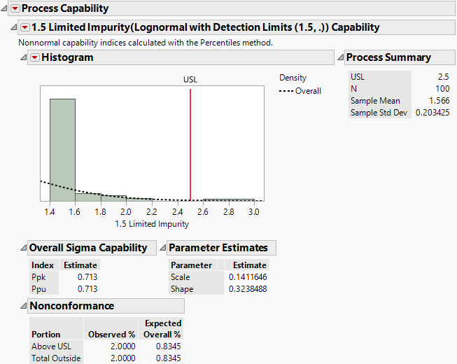

14. In the Column Switcher, select 1.5 Limited Impurity.
Figure 3.26 Process Capability Report for Impurity with Detection Limit of 1.5
The Process Capability analysis uses a censored lognormal distribution to take into account that the values of 1.5 are censored observations. The report title below Process Capability indicates the detection limits that are present for this analysis.
