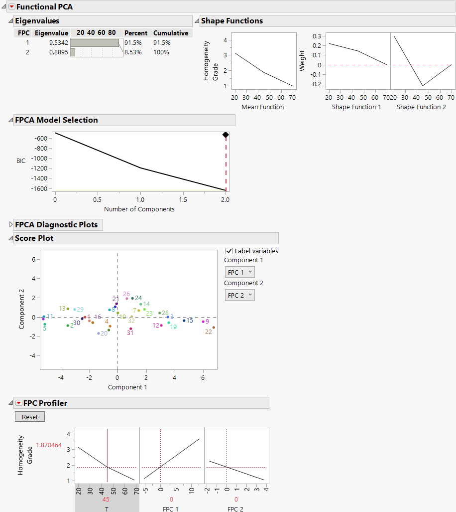

8. Click the Functional Data Explorer red triangle and select Models > B-Splines.
The best fitting model is a linear spline model with one knot.
Figure 16.10 Functional PCA for Homogeneity GradeĀ
The Functional PCA report shows that two functional principal components are needed to explain the variability in the data. The FPC Profiler shows how Homogeneity Grade is affected by the FPCs across the different temperatures. However, there is no way to tell how the actual ingredients affect the Homogeneity Grade.

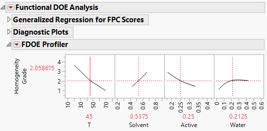

9. Click the red triangle next to B-Spline on Initial data and select Functional DOE Analysis.
The Functional DOE Analysis option fits a generalized regression model to each principal component score using the three supplementary variables as predictors. Because the data table contains a Model script, the models that are fit are based on the model defined in the script.
Note: If your data table does not contain a Model script, a two degree factorial model is fit.
Figure 16.11 FDOE Profiler for Homogeneity GradeĀ
The FDOE Profiler enables you to explore how Homogeneity Grade changes based on the predictors that you are actually interested in. In general, Homogeneity Grade seems to decrease as the amount of Active increases.
Note: In this example, the values of Active, Solvent, and Water are constrained to sum to 1. This constraint is reflected in the profiler.
