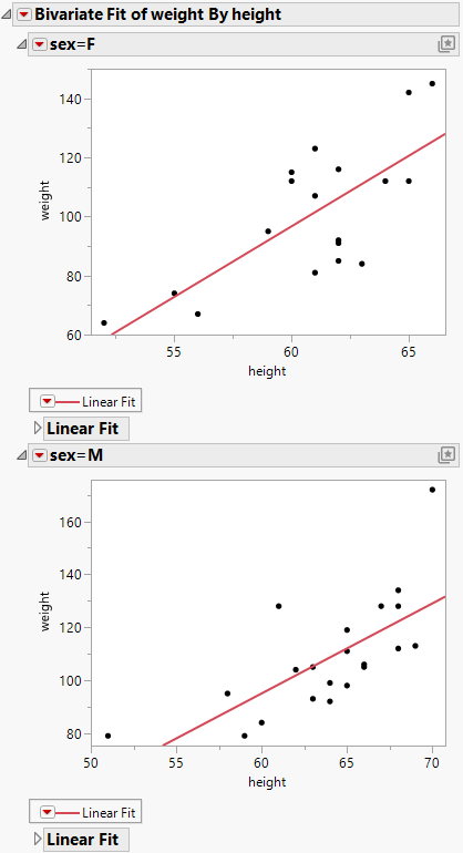

This example shows grouping by specifying a By variable in the Bivariate launch window. This results in separate reports and graphics for each level of the By variable (or combinations of By variables).
4. Select height and click X, Factor.
5. Select sex and click By.
6. Click OK.
7. Press Ctrl, click the Bivariate Fit red triangle and select Fit Line.
Figure 5.21 Example of By Variable PlotsĀ
There are separate analyses for each level of the By variable (sex). You see a scatterplot for the females and a scatterplot for the males.
