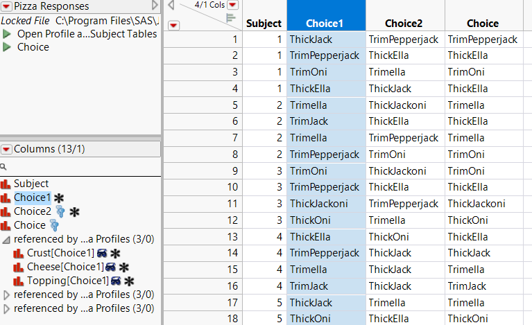

3. Select the Choice1, Choice2, and Choice columns in Pizza Responses.jmp, right-click, and then select Link Reference > Pizza Profiles.jmp.
The selected columns are linked to the ID column in Pizza Profiles.jmp.
Figure 6.37 Selected Columns in Virtually Joined Data Table

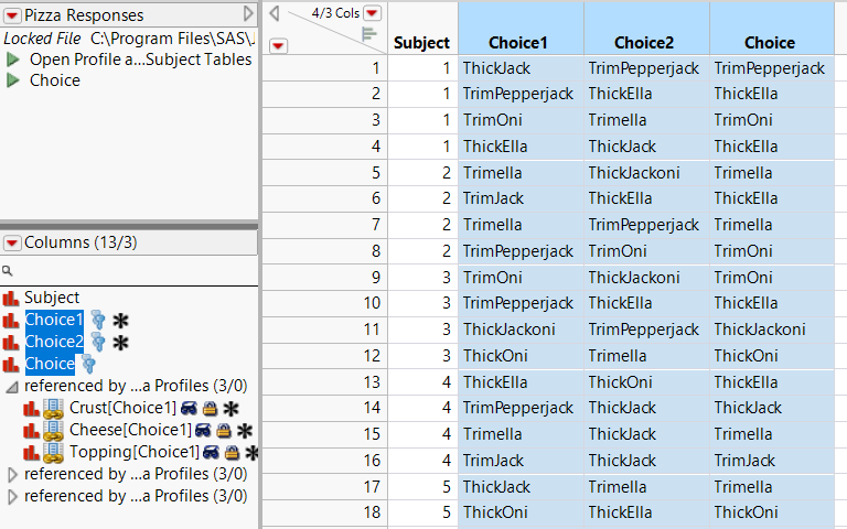

4. In Pizza Responses.jmp, select the Choice1 column if it is not already selected.
Note: If you do not select the columns, then all columns will be in the merged data.

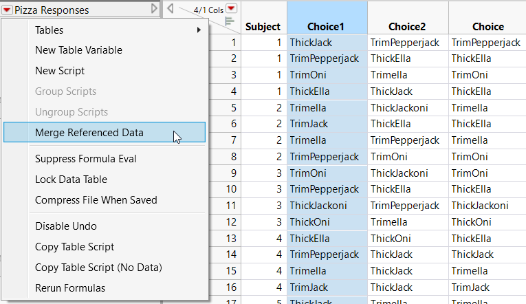

5. Click the red triangle next to the name of the data table and select Merge Referenced Data.
Figure 6.38 Merging Referenced Data
A message confirms that the selected column was merged. Notice that the blue virtual join icon for Choice1 no longer appears in the Column list. The Link Reference column property was removed.
