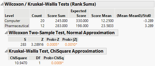

7. Click the Oneway Analysis red triangle menu and select Nonparametric > Wilcoxon / Kruskal-Wallis Test.
Figure 6.23 Wilcoxon Test Results
Both the normal approximation that uses a 0.5 continuity correction and the chi-square approximation for the Wilcoxon test statistic indicate significance at a p-value less than or equal to 0.0010. You conclude that there is a significant difference in the location of the distributions, and conclude that mean profit differs based on company type.

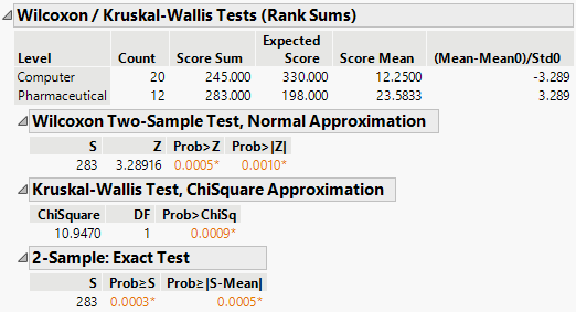

8. Click the Oneway Analysis red triangle menu and select Nonparametric > Exact Test > Wilcoxon Exact Test.
Figure 6.24 Wilcoxon Exact Test Results
The observed value of the test statistic is S = 283. This is the sum of the ranks for the level of Type with the smaller sample size (pharmaceuticals). The probability of observing an absolute difference from the mean midrank that exceeds the absolute value of S minus the mean of the midranks is 0.0005. This is a two-sided test for a difference in location and supports rejecting the hypothesis that profits do not differ by type of company.
