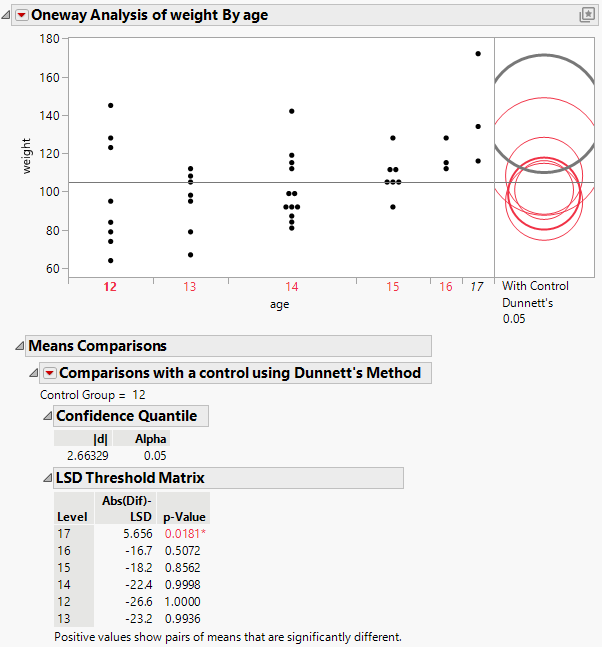

Figure 6.19 Example of With Control, Dunnett’s Comparison Circles
Using the comparison circles or the results in the LSD Threshold Matrix, you can conclude that level 17 is the only level that is significantly different from the control level of 12.
