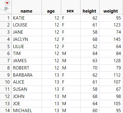

Figure 6.47 The Updated Big Class.jmp TableĀ
You can see that the height values in the updated table no longer match the values in the original table. The values have been updated to use the newer values from the New Heights.jmp table.
