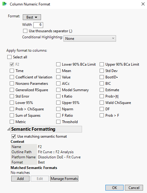

1. Right-click in the table that you want to reformat a row in and select Format Column. The Column Numeric Format window opens.
Figure 9.78 Column Numeric FormatĀ
Note: Your window may display different formats and values.
2. Expand the Semantic Formatting section of the window.
The semantic information about the table is listed: Name, Outline Path, Platform Name, and Format.
3. Click Add. The Create Semantic Format window opens.
Figure 9.79 Create Semantic FormatĀ
4. Specify a name for the format.
5. In the Format section, make the desired changes to the format.
6. Select the criteria and options that you want to apply to the format. Wild cards can be used.
7. Click OK in the three windows.
