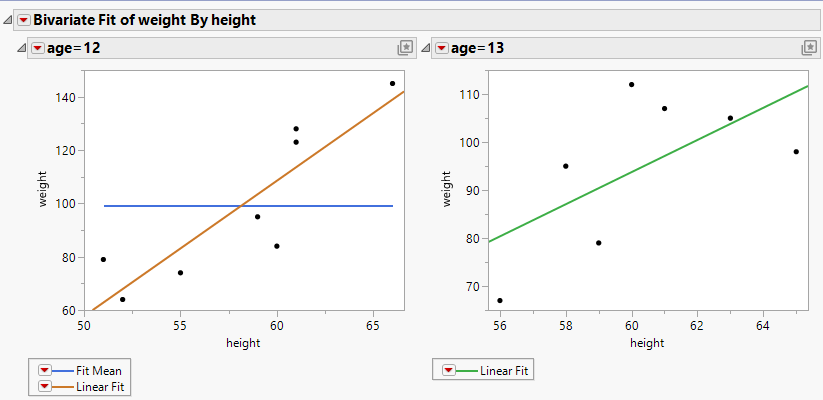

Use the Group Platform to manage and arrange reports for platforms that are created when a By role or multiple Y roles platform is launched. A Group Platform cannot be created directly. It is created when a launch creates multiple platforms.
Figure 9.76 Example of the Group Platform OptionĀ
Note: The Group Platform can be used across many analysis and graphing platforms. The Group Platform menu appears only if you have specified a By role or multiple Y roles. Use the Group Platform options to manage and arrange other platforms.
