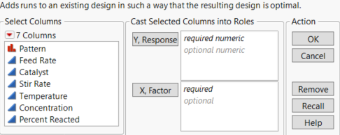

With the data table that contains the design that you want to augment open, launch the Augment Design platform by selecting DOE > Augment Design.
Figure 6.9 Augment Design Launch Window
Y, Response
Enter the numeric response column or columns. Entering a response is required.
X, Factor
Enter the factor columns. Factors can be of any data type or modeling type.
