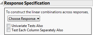

In the Manova Fit report, specify the response designs for various tests using the Response Specification panel.
Figure 10.4 Response Specification PanelĀ
