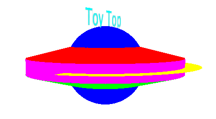

The JSL example below uses Push Matrix and Pop Matrix to position pieces of the toy top and then return to the origin. This is faster than using the Translate message a second time in reverse.
Figure 13.15 Drawing With a Matrix StackĀ
toyTop = Scene Display List();
toyTop << Push Matrix;
toyTop << Translate( 0, 0, .1 );
toyTop << Color( 1, 0, 0 ); // red
// baseRadius, topRadius, height, slices, stacks
toyTop << Cylinder( 1, .2, .2, 25, 5 );
toyTop << Pop Matrix;
toyTop << Translate( 0, 0, -.1 );
toyTop << Rotate( 180, 1, 0, 0 );
toyTop << Color( 0, 1, 0 ); // green
toyTop << Color( 0, 0, 1 ); // blue
toyTop << Sphere( .5, 30, 30 ); // radius, slices, stacks
toyTop << Color( 1, 1, 0 ); // yellow
// innerRadius, outerRadius, slices, rings, startAngle, sweepAngle
toyTop << Partial Disk( 1, 1.2, 25, 2, 0, 270 );
toyTop << Color( 1, 0, 1 ); // magenta
toyTop << Cylinder( 1, 1, .2, 25, 3 );
toyTop << Rotate( 90, 1, 0, 0 );
toyTop << Translate( 0, .5, 0 );
toyTop << Color( 0, 1, 1 ); // cyan
toyTop << Text( "center", "baseline", .2, "Toy Top" );
scene = Scene Box( 600, 600 ); // make a scene box...holds an OpenGL scene
New Window( "Example 3", scene ); // put the scene in a window
scene << Perspective( 45, 3, 7 );
scene << Translate( 0.0, 0.0, -4.5 );
scene << Rotate( -85, 1, 0, 0 );
scene << Rotate( 65, 0, 0, 1 );
scene << Call List( toyTop );
scene << Update; // update the display box
