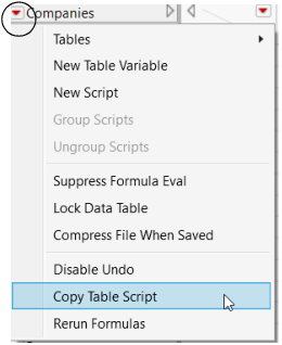

1. In the data table, select the red triangle next to the data table’s name.
2. Select Copy Table Script.
Figure 3.3 Copy the Table Script
