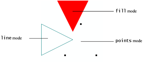

Fill Pattern
Polygons are rendered with both a front and a back, and the drawing mode of each side is customizable. This enables the user to see the difference between the back and front of the polygon.
To set the drawing mode of a polygon, use the Polygon Mode command.
Polygon Mode( face, mode )
where face can be FRONT, BACK, or FRONT_AND_BACK, and mode can be POINT, LINE, or FILL.
Figure 13.12 Points, Line, and Fill Modes
For example, the following script creates a display list that defines a triangle. This display list is used three times in conjunction with Translate, Rotate, and Color commands to draw triangles in three positions. In addition, the Polygon Mode command changes the drawing mode of each triangle. Note there is no explicit call to the FILL mode, since it is the default.

Table 13.2 Translate and Rotate Commands
Code from above script
comments
shape = Scene Display List();
Creates a display list
shape << Begin( TRIANGLES );
shape << Vertex( 0, 0, 0 );
shape << Vertex( -1, 2, 0 );
shape << Vertex( 1, 2, 0 );
shape << End();
Creates a display list named shape that holds vertices for the triangles. All the z vertices are zero since this is a two dimensional scene
scene = Scene Box( 200, 200 );
New Window( "Fill Modes", scene );
scene << Ortho2d( -2, 2, -2, 2 );
Put the scene in a display box, and create a new window.
scene << Color(1,0,0);
scene << Call List( shape );
// update the scene to see the triangle
scene << Update;
Draw the first triangle in red.
scene << Rotate ( 90, 0, 0, 1 );
scene << Translate ( -0.5, 0, 0 );
scene << Color( 0, 0.5, 0.5 );
scene << Polygon Mode( FRONT_AND_BACK, LINE );
scene << Update;
Draw the second triangle in teal. Note that we first rotate the triangle.
And then translate it.
scene << Rotate( 90, 0, 0, 1 );
scene << Translate( -0.5, -1, 0 );
scene << Color( 0, 0, 0 );
// large points so that they are visible
scene << Point Size( 5 );
scene << Polygon Mode( FRONT_AND_BACK, POINT );
scene << Update;
Draw the third triangle as black points. First rotate.
And then translate to get the final picture.
