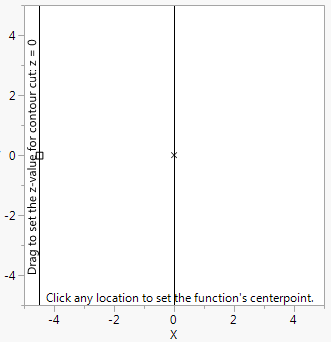

This example uses both Mousetrap() and Handle() to draw a three-dimensional function centered on the Mousetrap() coordinates, where the single contour line takes its value from a Handle().
x0 = 0;
y0 = 0;
z0 = 0;
win = New Window( "Viewing a 3-D Function in Flatland",
	Graph Box(
		Frame Size( 300, 300 ),
		X Scale( -5, 5 ),
		Y Scale( -5, 5 ),
		Contour Function(
			Exp( -(x - x0) ^ 2 ) * Exp( -(y - y0) ^ 2 ) * (x - x0),
			x,
			y,
			z0 / 10
// get the z-cut values from a handle
		Handle( -4.5, z0, z0 = Round( y * 10 ) / 10 );
				V Line( -4.5 );
		Text Size( 9 );
		Text(
			Counterclockwise,
			{-4.6, -4},
			"Drag to set the z-value for contour cut: z = " || Char( z0 / 10 )
		Marker Size( 2 );
		Marker( 2, {x0, y0} );
		Mousetrap( // set the origin to the click-point
			x0 = x;
			y0 = y;
		Text(
			{-4.25, -4.9},
			"Click any location to set the function's centerpoint."
Note: Instead of setting x0 to x and y0 to y in the Mousetrap() expression, you might want to use Function( {xx, yy}, Show( xx, yy ); x0 = xx; y0 = yy );. xx and yy are formal parameters to the function. They come from arguments that the mousetrap passed when the user clicked on the graph. The Function( {xx, yy}...) alternative makes the xx and yy names explicit, and makes it clear the you can name them anything, not just x, y.
Figure 12.27 Mousetrap() and Handle()
