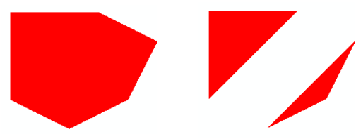

The first section of the script creates a display list named shape. Inside this display list, a polygon is defined using six vertices.
The second section of the script creates a scene box and a new window. It then uses the Call List message to put the list in the display.
Note that all the z-coordinates are zero, which makes sure the polygon lies in a plane. Polygons that do not lie in a plane can cause unpredictable results.
Experiment with the line
shape <<Begin(POLYGON);
by changing it to some of the other primitive types. For example, changing it to
shape <<Begin(TRIANGLES);
results in a different picture.
Figure 13.10 Polygon (left) and Triangles (right)
