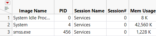

You can also print the task list directly without using cmd.exe and then import the task list into a data table.

Figure 8.4 Imported Data from Run Program()
