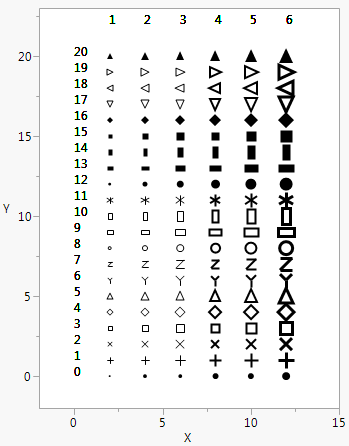

Marker() draws a marker of the type that you specify (1–20) in the first argument at the point that you specify in the second argument. Marker Size() scales markers from 0 to 6 (dot to XXXL). To set markers to the size that is specified in the Preferences, use a value of -1.
ymax = 20;
win = New Window( "Markers",
	Graph Box(
		Frame Size( 300, 400 ),
		X Scale( -2, ymax - 5 ),
		Y Scale( -2, ymax + 3 ),
		For( j = 1, j < 7, j++,
			Marker Size( j );
			For( i = 0, i < (ymax + 1), i++,
				Marker( i, {j * 2, i} );
				Text( {0, i}, i );
				Text( {j * 2, ymax + 2}, j );
Figure 12.13 Drawing Markers
Drawing Markers
