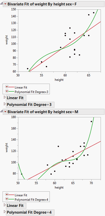

The following example uses the Big Class.jmp data table, which contains the names, ages, sex, heights, and weights for 40 students. Create a bivariate report of weight by height, using sex as a By variable, and adding a variety of fits.
Create the Bivariate Report Using a By Variable
1. Select File > New > Script.
2. Add the following lines:
biv = dt << Bivariate( Y( weight ), X( height ), By( sex ));
The first line opens the Big Class.jmp sample data table. The second line creates a platform object called biv that runs a bivariate report of weight and height by sex.
3. Click Run Script Image shown here.
The report window shows two graphs, one where sex is F and one where sex is M.

In the log, rather than returning a single reference to a platform, Bivariate[], the platform object returns a list of references: biv = {Bivariate[], Bivariate[]}. The two references correspond to the two levels (F and M) of the By variable, sex.
You can direct messages to each By level individually or to all By levels.
4. Send a message to all By levels to add a linear regression fit. Add this line to the script:
biv << Fit Line;
5. Highlight the line you just created and click Run Script Image shown here.
In the report window, a linear regression line is added to both graphs, with the corresponding Linear Fit reports.
6. Send a message to only the F level, adding a cubic polynomial fit. Add this line to the script:
biv[1] << Fit Polynomial( 3 );
Tip: The number for each By level corresponds to their order in the report window, which is usually alphanumeric. If the By column contains a Value Order column property, that ordering is followed.
7. Highlight the line you just created and click Run Script Image shown here.
In the report window, a polynomial fit line is added to the F graph, with the corresponding Polynomial Fit reports.
8. Send a message only to the M level, adding a quartic polynomial fit. Add this line to the script:
biv[2] << Fit Polynomial( 4 );
9. Highlight the line you just created and click Run Script Image shown here.
In the report window, a quartic fit line is added to the M graph, with the corresponding Polynomial Fit reports.
